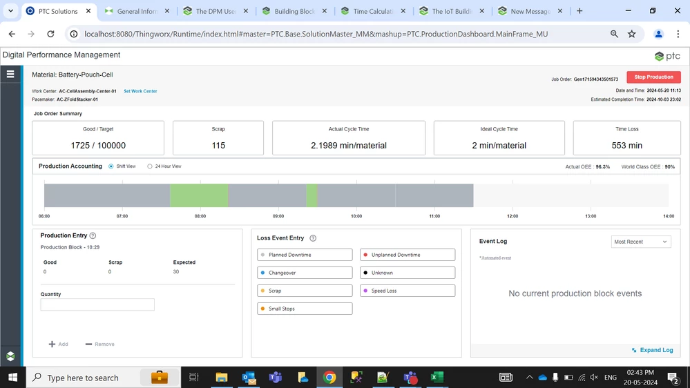

In DPM production Dashboard, we have a production accounting section inside that it is showing a delay of around 2 hours is it normal?
Please check system time and production accounting time

This is time-zone related. The AC-Cellassembly is probably located in Germany, The "Date and Time" you see is the machine time, so everyone sees the same screen independent from where you consume the mashup.

Hello Rocko,
Thanks for the response could you please share how to change workunit timezone.

I guess you can't, the timezone is defined on site level and can't be updated. Create a new site with the proper timezone and equipment associated to that site.
https://support.ptc.com/help/digital_performance_management/r9.5/en/#page/dpm/digital_performance_management/equipment_list_administration/site_configuration_tab.html
