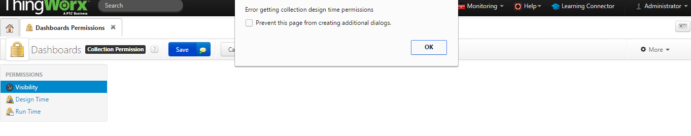

Hello Everyone,
When I am clicking on lock option of dashboard permission, It is throwing following errors:
Error getting collection design time permissions.
Error getting collection run time permissions.
Error getting collection visibility time permissions.
I cancelled all the errors and clicked on visibility, design time and run time and found there is nothing to do.
I am login with Administrator account.
Please suggest a way, How could I set permissions for dashboard and sort out this error.
Meenakshi
