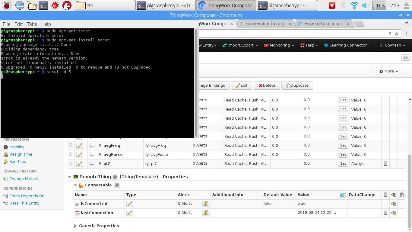

While running sudo ./wsems I was able to ping my Thingworx (I have attached the screenshot)
Can someone please help me solve this error? is it a problem with my port

Hello! Thanks for posting your question in our Community.
For the error:
www.iotspace.io:80-->[WARN ] 2018-08-24 06:22:10,960 WsEmsProxy :: bindThing: Exception connecting to localhost:8001. Err: Connection refused [localhost:8001]
That may indicated a problem with talking to port 8001, check to be sure there are no active firewall blockages on that port. Also, what version of the EMS are you running?
This other post shows similar errors, and looks like it's still a work in progress.
-- Craig A.
Gowresh_R1-VisitorAuthor
August 24, 2018
Hello Craig! Thanks for your reply.
Yes. You were right. I forgot that the default port value will be taken if not specified. I specified the port name under "auto_bind". Now that error was eliminated. This is the log I get now:
