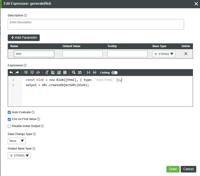

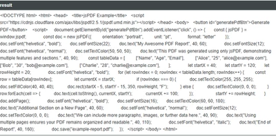

So for everyone else ,our solution was that in thingworx service we have choosen html as output and use jsdpf library as below:-
then on mashup load this service runs and assigns it to expression.
  • html is passed as a parameter (it contains HTML content as a string — from service).
  • A Blob is created with type "text/html".
  • The Blob is converted into a temporary URL using URL.createObjectURL(blob).
  • The output is a usable browser URL like blob:http://your-server/....

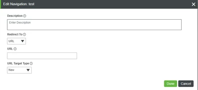

the output of expression we have assigned to NAVIGATION for url and then by clicking a button on mashup... it takes us to new tab and there i can generatepdf from my html..
one can also inject in html in thingworx like to fill the values any where with the code below:-
let template = Things["dummy.FileRepository"].LoadText({
path: "/PLN1/test.html"
template = template.replace("{{name}}", yourName);
template = template.replace("{{date}}", yourDate);
result = template;
I am happy to listen further suggestions about it...
