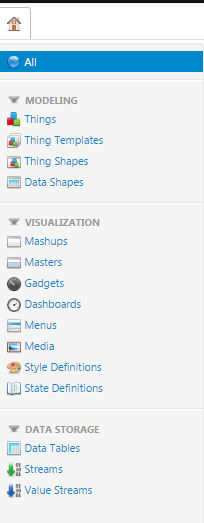

Dimitri, does these developers don't need access to the various components for modeling and visualization? As these options are on Composer , i think if you restrict their rights for creating, editing or deleting for other entity collections it should be sufficient. Even though they be able to land on Composer page but only with restricted view of the composer e.g.
Hope this helps.

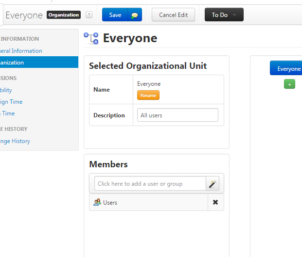

Hi Dimitri, is Users group part of the Everyone Organization? Something like this
If they are please remove them and this should make all the users (except) Administrator go to the SQUEAL page if they don't have a Home Mashup set - you can set the Home Mashup as explained by Mathias above
