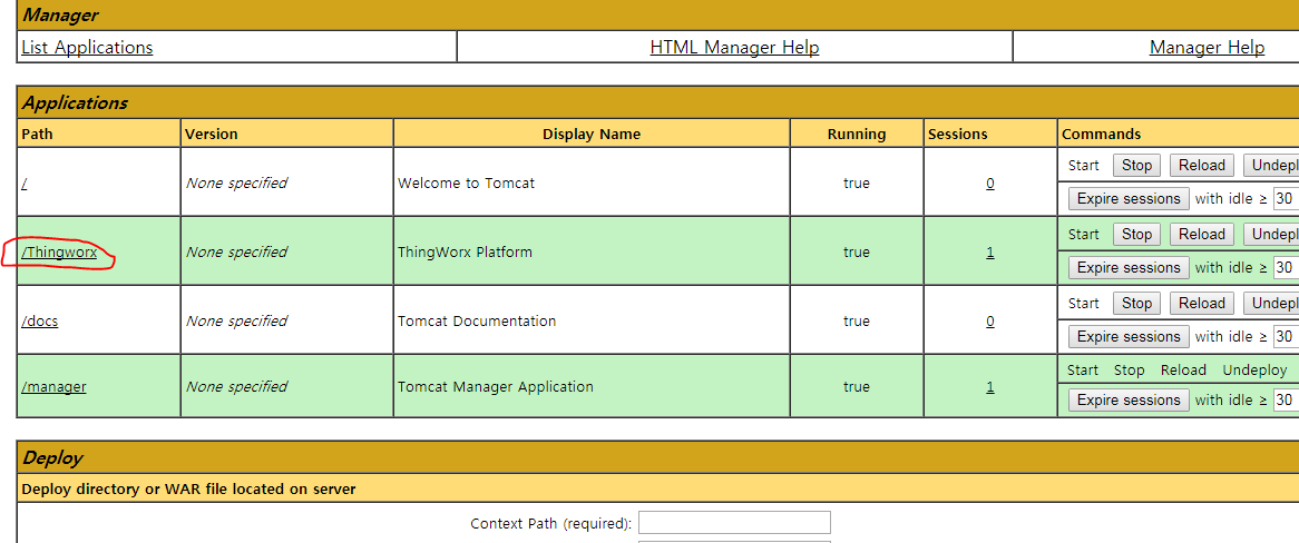

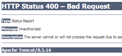

Hi i installed Thingworx 8 and got HTTP Status 400..
it was click in tomcat manager app
and appear this page
but when i tried to connected IPv4Adress/Thingworx[ex xxx.xxx.xx.xx/Thingworx and xxx.xxx.xx.xx was my Ipv4address]
it was worked

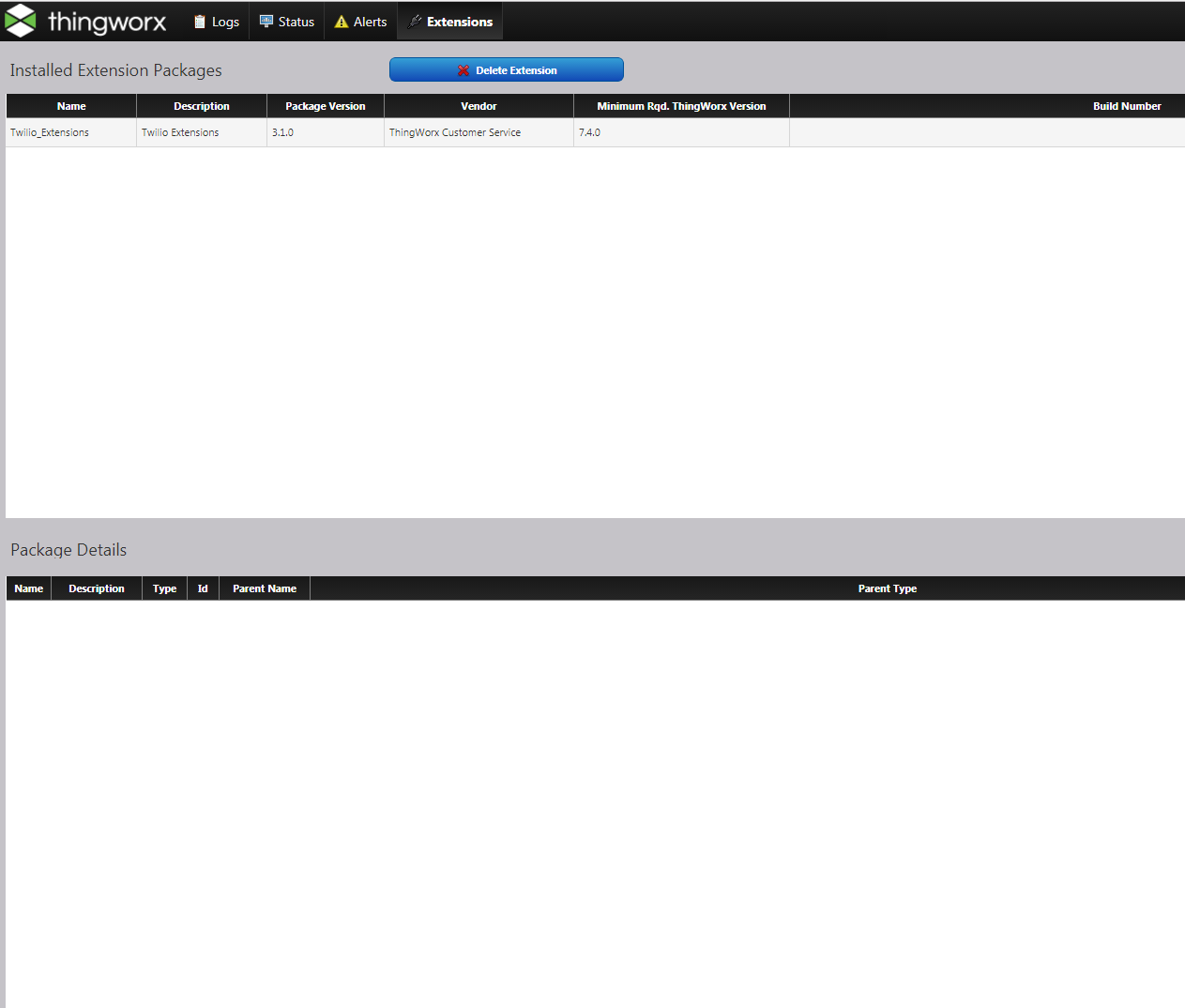

and look for extension monitor but anything doesn't exist
[twillio was import extension after installed TWX]

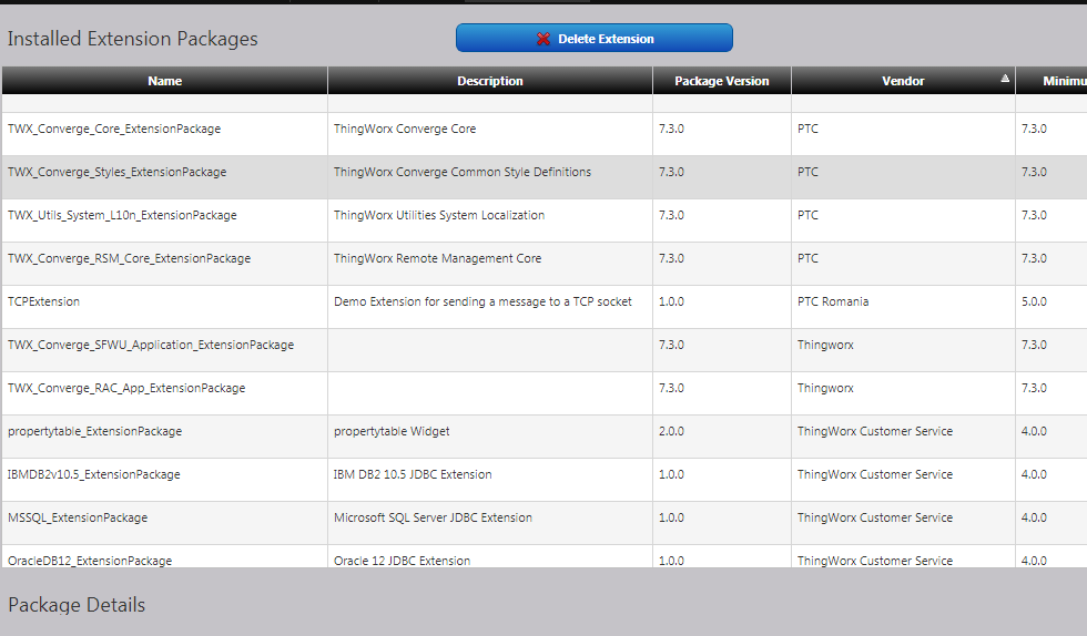

so i checked the other TWX that was installed version 7.3 which other computer
there are some Extension Vendor PTC..

so i export ThingworxStorage but when i import this apeer
i think that problem cause my local TWX didn't has TWX Extension package vendor PTC
so i want solve this question
one is connected By localhost/Thingworx [don't typing xxx.xxx.xx.xx/Thingworx]

i change TWX 7.3 cause try installed TWX navigate
and HTTP 400 doesn't appear
