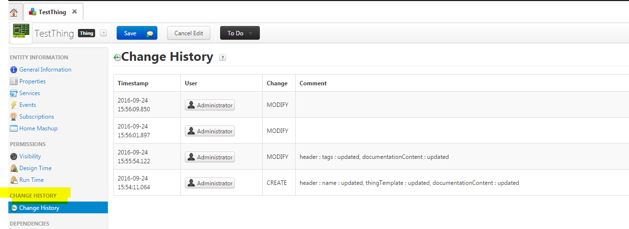

Please clarify your question , as in what are you trying to do ?
Changes made to a Thing in Thingworx can easily been seen in Change History.
Please see the screenshot and let me know , if this is what you are looking for .
