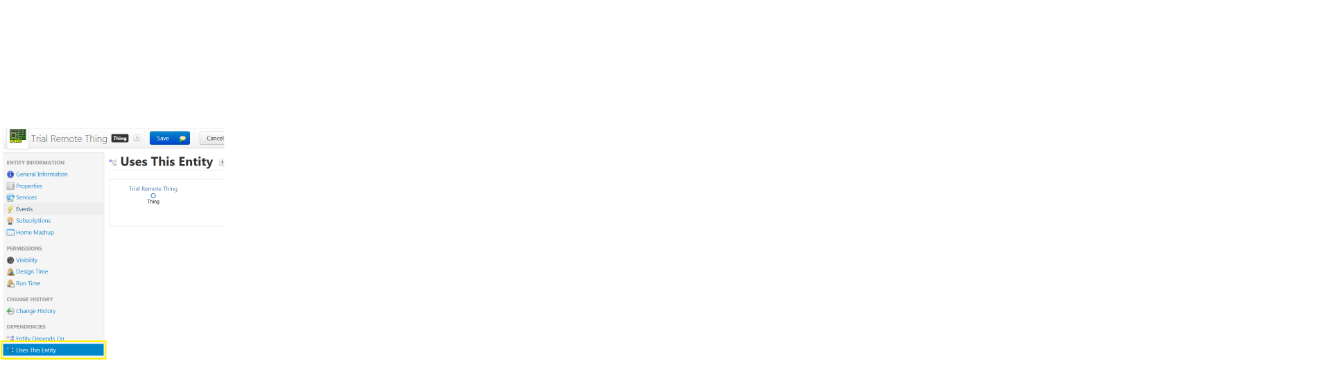

    Hi Bhuwaneshwar,
    You can find which entity depends on your Thing by clicking on the "Uses this Entity" on the Dependencies tab.
