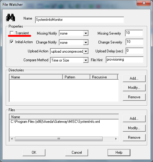

I do not have full knowledge of your current deployment but assuming you are using Axeda Agent you can upload files using agent's File Watcher capability. File Watcher can observe individual files or folders and when the file content or timestamp changes it can upload the file to the platform. Secondly, you can instruct the File Watcher to delete the file once it has been sent to the platform. This is done by setting the Transient option in the File Watcher dialog.
Here is what Builder's help has to offer on the Transient settings:
Transient
If selected, when the file watcher runs, all watched files are processed and then deleted from the device. If not selected (non-transient), when the file watcher runs, the Axeda Agent processes only watched files that have changed (based on the selected Compare Method) since the last time the file watcher ran; no watched files are deleted from the device. (For non-transient file watchers, the first time file watcher runs, all watched files are processed.)
