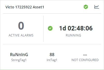

#1 : Yes, you can use string values in AMU, but you might have some limitations if you try to use it as the status or if you want to use special values for alarming, also I never tried them in Troubleshooter (the trending/graph tool). For logging all the tag values, yes this part works as expected. The way it works in AMU is the values will be in Valuestream for a few moments and then AMU will transfer them to the AttributeValue table of the other database.
#2 : Same as with other tags : go in the Configuration -> Equipment -> Attributes screen, create an attribute, select your tag.
#3 : Like I said in #1 I don't remember how it works in the Troubleshooter/trend. But in the Asset Card (the card with the 9 attributes), it should display the values automatically, without you needing to do anything else. There may be a limit to the number of characters shown in the screen.
Here is an example I made recently (look at StringTag1) :
To accomplish this, I simply created an equipment in the Configuration -> Equipment screen and created 2 attributes : one for my string tag and one for my integer tag. And then in the Asset Card tab I selected them both and also selected the status.
