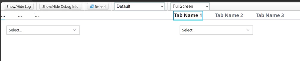

How can I add different icons for a tabset in version 9.4
I tried to use custom css and went for @supports ..... custom css, but this is impacting other mashups and showing icon there as well .

Feb 26, 2024 7:40 AM UTC
I did but that is impacting other mashups its reflecting the icon in other mashups where its not needed
Feb 26, 2024 10:02 AM UTC
Hi @VN_10171538
If you use elementId in CSS it won't affect other mashup tabset icons
For example: I have changed the width of Tabset with element id : root_ptcstabset-117
@supports (ptcs-style-unit: "#root_ptcstabset-117.PTCS-TABSET"){
 [part~=tabs-tab] {
 		width: 15px;
 		background: #ffffff;
 		border-radius: 0px;
		border-bottom-color: #d8dbde;
 		border-top-color: #d8dbde;
And it does not affect other tabset in the same mashup
/VR
