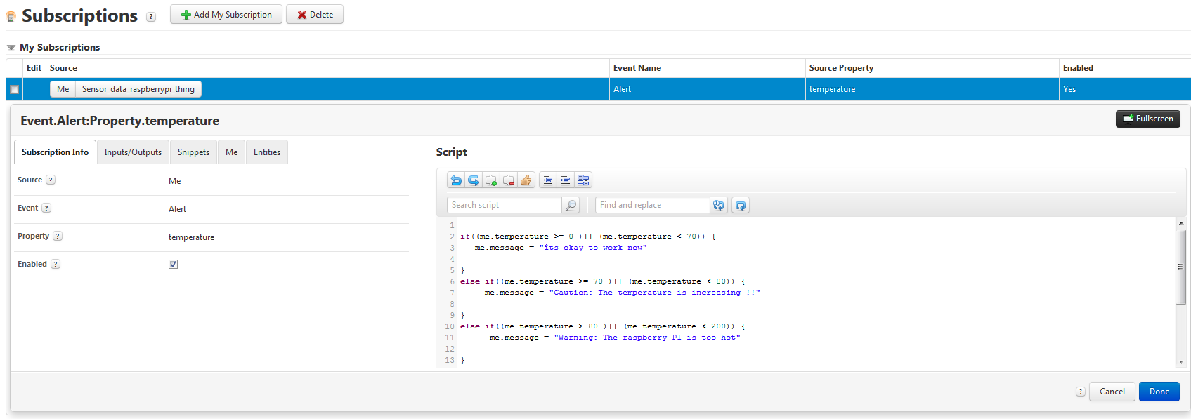

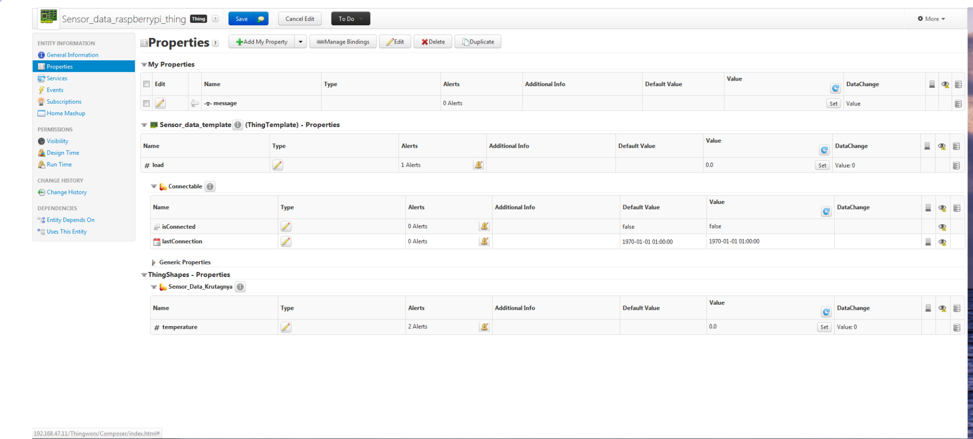

Thank you for your reply. I tried doing what you said, but I am still not able to display the the message in the mashup.  Below is the method that I used,
1) This is what my Thing looks like:
2) This is my subscription
3) when I connect mashup to this subscription, it doesnot display any data.
December 6, 2017
After reading your subscription script I think I have a better idea of what you’re trying to accomplish. In this case, change your subscription to “Data Change” and tie it to your temperature property. You can keep the same script you wrote. Now, anytime the temperature changes it will change the message accordingly. Now in your mashup, use the GetPropertyValuesService to have the “message” property available. Drag a Label widget into your workspace and tie the “message” property to it.
