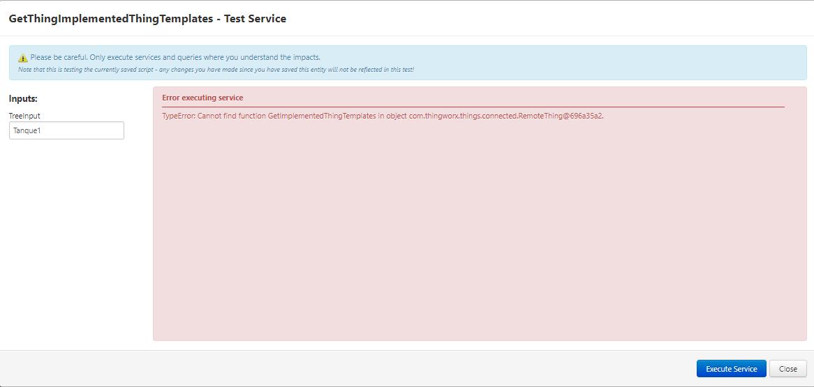

I have this service to get the ThingTemplate implemented by a set of Things wich implements different Thing Templates.
The code:
result = Things[ThreeInput].GetImplementedThingTemplates().toInfoTable();
But when testing it, it throws the following error:
Does anybody knows what is the solution to this?
Thanks on advance.

Josue Serrano​,
A Thing could only extends one Thing Template but it could implement more than one Thing Shapes, so in your case, if you want to get the Thing Template a Thing extends/implements, you should do with:
result = Things["TestThing"].GetThingTemplate();
If you want to get the Thing Shape list a Thing Implemented, you need do with:
var result = Things["TestThing"].GetImplementedShapes();

Hi Josue,
Alternatively to GetThingTemplate() which returns an infotable of just one row, you can also use .thingTemplate Thing's property
Best Regards,
