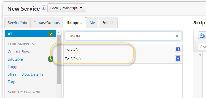

    Lipsa, you could try the Universal Converter Extension to get you the Infotable and then you can have that Infotable converted to JSON with couple of out of the box toJSON services already available in the composer
