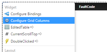

Dear Team,
I need to hide one  column name from grid.
How can we achieve.
March 17, 2017

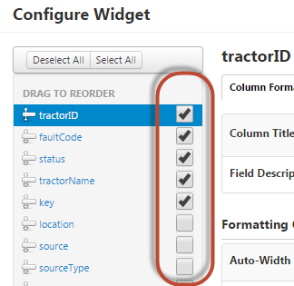

Bhuwaneshwar, you can use the Configure the Grid Columns directly from the Mashup where you have your Grid widget, something like this
You can enable/disable the visibility of the columns here
