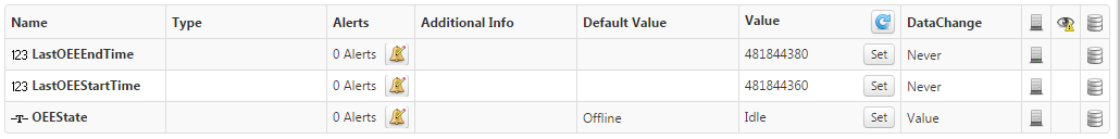

In Thingworx, then, I have an entity that is bound to the device, The entity has 3 properties: LastOEEStartTime, LastOEEEndTime and OEEState all marked IsLogged:true. I defined OEEState with aspect DataChange Value and the other two with DataChange:Never. I thought this would do it.

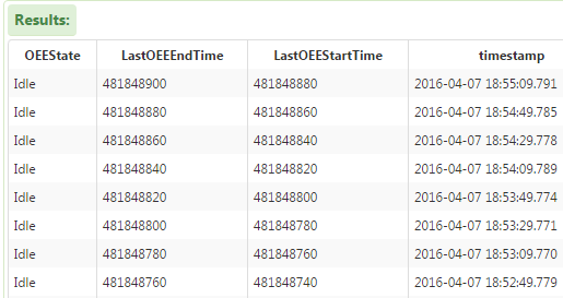

The results of QueryPropertyHistory show that I am getting a record in the Value stream for every record the device is sending. Why is that?
It seems that I am getting a new entry in the value stream every time the OEEState property is written to whether the value has changed or not. Is this what I should expect?

This result is correct, because you have marked all three properties as Logged. If you just want to display the OEEState, then go to the other two properties and uncheck the Logged checkbox. The timestamp is add to the query of the value stream by default.

You can just do the specific QueryNamedPropertyHistory or QueryStringPropertyHistory to just recall the one column, and it will give you just that column. Something looks wrong though, I don't see any value changes between the recorded items, did you set the DataChange to Always vs. Value?

What the device is doing is recording the state every 20 seconds whether it changes or not, so the start and end times are changed with every record.
Then if the state value changes, we get a pair of records that gives the time when the previous state ended and the next state began.
What I want to do is "boil" the stream down to just the records where the state value has actually changed.
