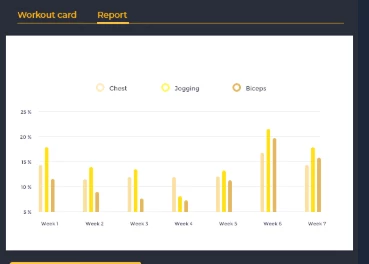

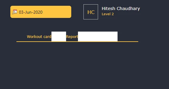

How i remove tabs spacing between two tabs
 how i remove white spacing between two tabs as below attachment. And how i bind mashup to tab1 and tab2 like attachment below.

Hi @Ru_01
For the white space please look at this post Tab Widget: How to style the white space between tab headers and this article https://www.ptc.com/en/support/article/CS325847.
I am not sure you can bind an existing mashup to a tab, yo can though place widgets directly inside the tab and build your page this way.
Hope this helps
Christophe
