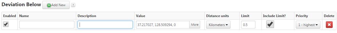

can i make this capture ussing subscription?
cause i use add value stream entry
so, doesn't work property alert
then, i want make this alert in subscription
Or could help me set the radius around with longitude and latitude
if i want  set surrounding radius value {35.xxxx,127.xxxx }around 1km
and i want change 35.xxxx,127.xxxx -> address
plz help me hehehe

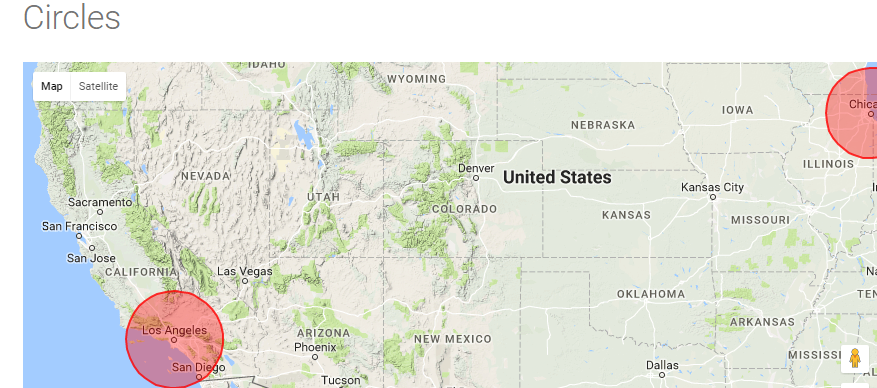

Hi Seonho, sorry I may not have fully understood your requirement, are you looking to create GeoFence with your data? something like this
