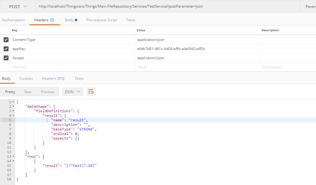

The correct way to do this is using the postParameter url parameter when invoking the service; here is an example:

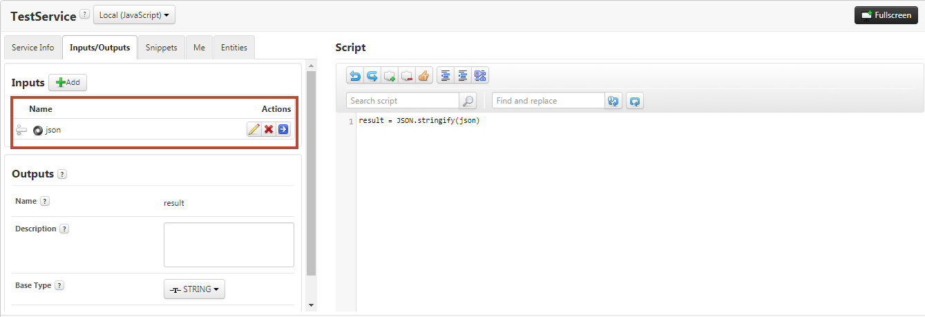

Create a service with the parameter name json
add the URL Parameter postParameter where the value is the name of the json parameter you wish to pass:
Here is a cURL example:
curl -X POST \
  'http://localhost/Thingworx/Things/Main.FileRepository/Services/TestService?postParameter=json' \
  -H 'accept: application/json' \
  -H 'appkey: efdb7b81-461c-4d04-bffb-a4e0fd2cd85c' \
  -H 'cache-control: no-cache' \
  -H 'content-type: application/json' \
  -H 'postman-token: c03973a6-a9ff-9786-1f88-47e757612c75' \
  -d '{"test": 10}

October 7, 2017
thanks it is clear
