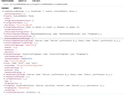

how to add service not a dynamic service in a thing via http request?
In the thingworx plantform we  add service and open developer tool we can see we have send a http request as below,in the body there are a lot of   parameters,
is  there any document show  how to add those parameter?
