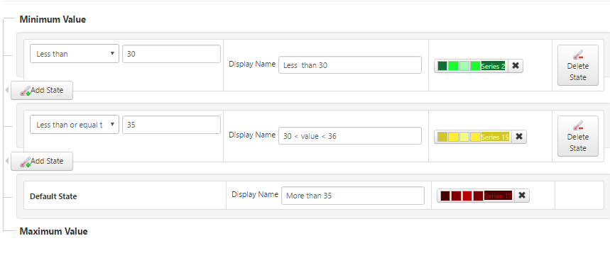

How can I add greter than condition in state definition?
Example if   state <30 green
state >35 red
else yellow

Hi Bhuwaneshwar, could do that with multiple states with less than target values. Have you already tried that?
March 14, 2017
Hi Bhuwaneshwar,
you can create State Definition only with "Less than" filters. The states are overwriting each other, so in your case it should look like this:
And the final result:
I hope it helps.
