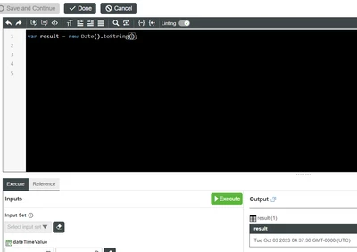

Hi @oskarberntorp
Yes, in Thingworx Date() returns a Unix timestamp.
To get the usual output, please use the toString() method to convert it
/VR
