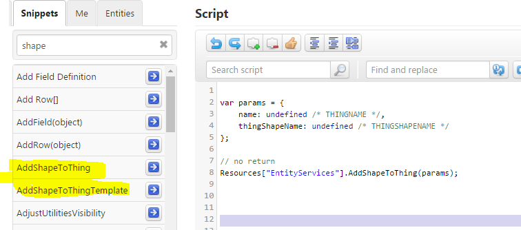

Best answer by posipova
You may use the snippets AddShapeToThing and AddShapeToThingTemplate
posipova20-TurquoiseAnswer
20-Turquoise
February 27, 2017

Just for the record, after Adding Thing Shape, if on the same code execution thread you want to use the new shape on the given Things, you should get a new reference to the Thing again ( as the Thing will restart ).
For instance if you add a ThingShape to yourself:
Resources["EntityServices"].AddShapeToThing({ name: me.name, thingShapeName: "whatevershape" });
// -- Now if you want to call a service or a property don't use me.propertyName or me.serviceName
// -- you should use Things[me.name].propertyName and/or Things[me.name].serviceName
// -- but you can't use me.name , then you should save previously your ThingName to a temp Variable
// -- Things[thingName].propertyName
