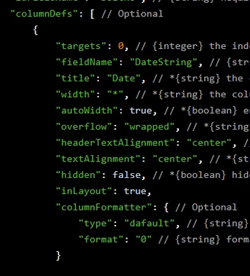

How to center align Grid header and value using Style Theme
Hello all,
How to center align Grid Header and Value using style theme
/VR

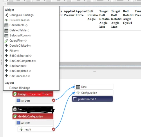

Support
February 13, 2020
Hi @Velkumar.
From our testing, we're not seeing an issue.  If you select the grid, in the upper-left corner is a drop-down.  From there you should select Configure Grid Columns.  You then have the ability to align the header or the data.
Please let us know if you're still having issues.
Regards.
--Sharon

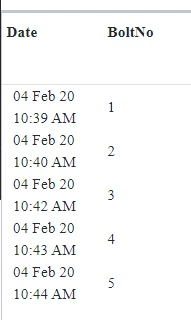

Velkumar19-TanzaniteAuthor
February 14, 2020
Hi @slangley
Thanks for your response. I have mapped configuration dynamically, so I'm not able to find 'ConfigureGridColumns ' in widget.
In configuration, I have mentioned 'textAlignment' as center
Still header and text are not aligned
/VR
