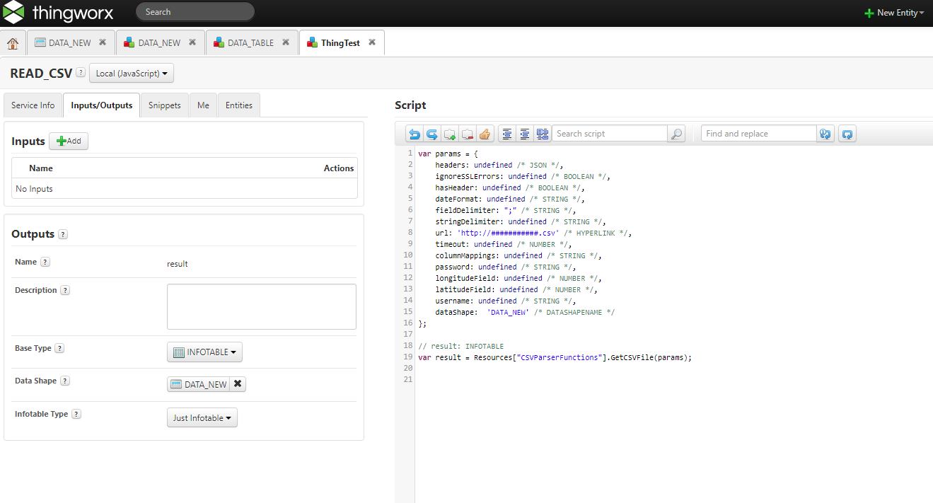

I want to extract data from infotable to be used in chart but my data is STRING.
how can i convert this data to be NUMBER to be used in chart? please suggest me how to do.
This is My data from CSV file.
Inverter type;Serial number;RS485 address;IP address;Yield[kWh]
Time;Udc1;Idc1;Pdc1;Uac1;Iac1;Uac2;Iac2;Uac3;Iac3;Pdc;Pac;Tsys[?C]
06:38:35;620.4;1.84;1147;227.6;2.02;225.8;1.92;226.6;2.13;1147;1124;37.4
06:43:40;625.5;2.36;1477;227.2;2.43;225.4;2.38;226.2;2.52;1477;1448;38.5
06:48:40;630.5;2.85;1797;226.8;2.86;225.1;2.84;226.0;2.93;1797;1760;39.5
06:53:40;633.3;3.27;2072;227.1;3.21;225.5;3.23;226.2;3.28;2072;2030;37.8
06:58:40;641.0;3.74;2400;227.0;3.69;225.2;3.70;226.1;3.74;2400;2352;37.2

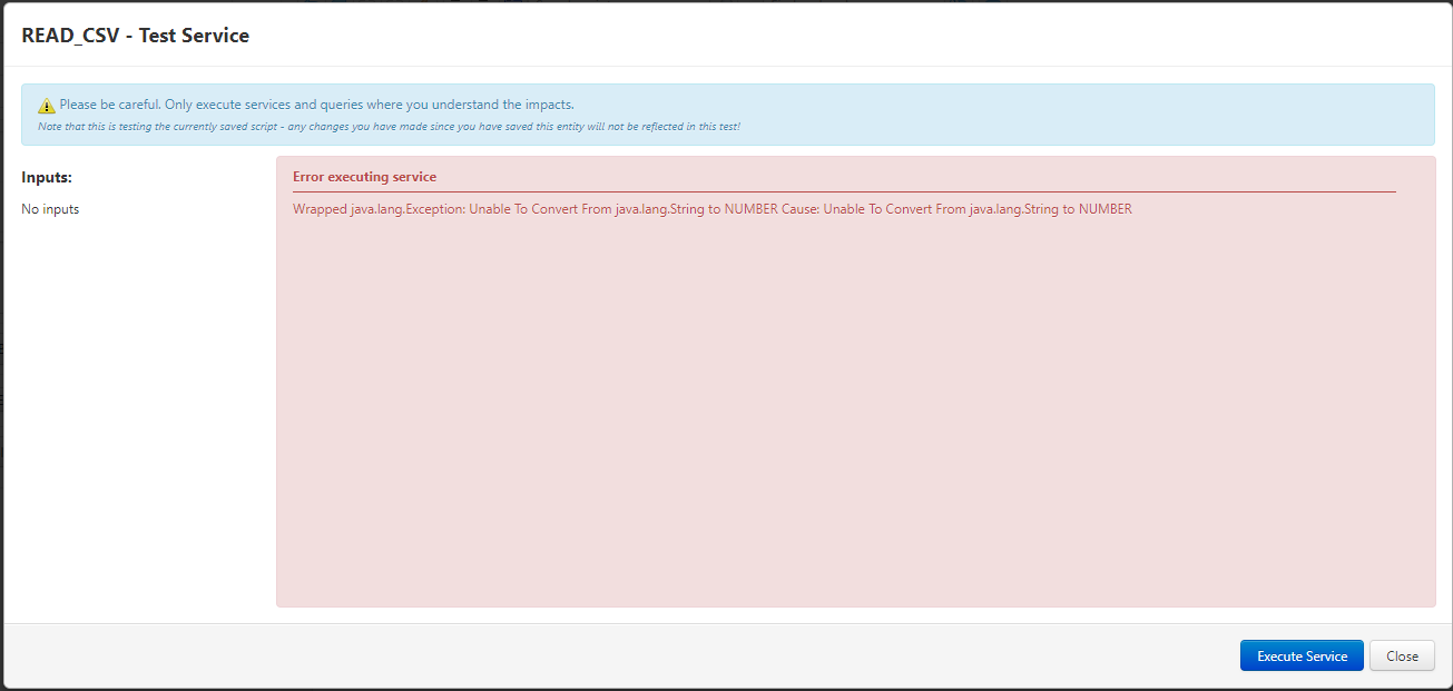

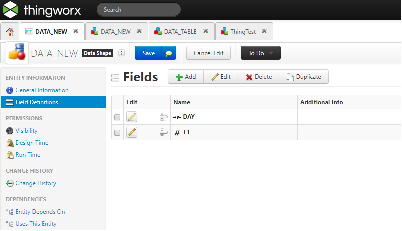

Hi Nuttapol Pomtong​,
Is it working when the DataShape is both String?
The number of Properties in DataShape and CSV is different.
Nuttapol12-AmethystAuthor
August 26, 2017
yes it work when both are String but i want to use with Label chart.
You use one of the function below to convert String to number/Integer/Float based on your requirement:
var MyNumber1 = Number("1000");
var MyNumber2 = parseInt("1000");
var MyNumber3 = floor(parseFloat("1000.01"));
I hope it helps.
