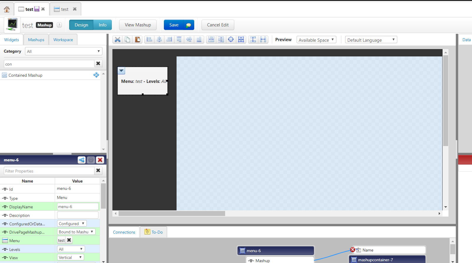

You are right and it is actually quite simple, just create a menu with the mashup you want to access to. In the mashup, drag and drop a menu widget and a mashup container and bind the menu to the mashup container:
Best regards.
