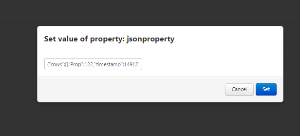

Keep in mind such a result would be displayed in a tabular format. However, you may save it to, for example, a property
result = table1.ToJSON();
Then when the property is assigned the converted toJson data, you will see the following:
