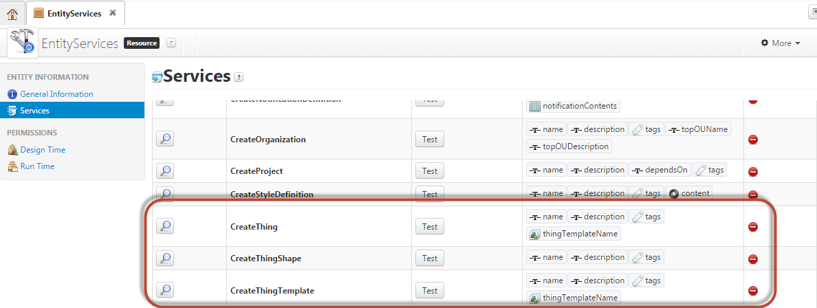

Is it possible to create remote thing on thingworx platform during runtime through simulator?
same way creation of remote templates is possible?
April 13, 2017
Hi Nisha, have you already checked the Create services available in EntityServices under Resources, using that you will be able to create Things/ThingTemplates and assign them the requires templates.
Hope this helps.
nbhagtani1-VisitorAuthor
April 17, 2017
Here we need to provide name and template etc is it possible to automate this process?
Like if i have create remote things or templates in my simulator same gets created in thingworx platform?
