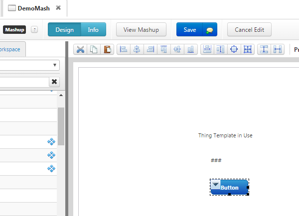

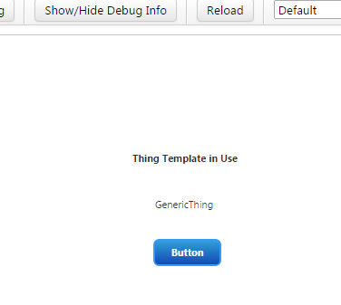

Hi Puntavut, is this service created on the platform or on the Edge SDK? In either case you will have to call this service and well there are several ways of doing so. The most common usage (keeping it simple) would be to create a Mashup and use any widget that can utilize the service you have created.
A simple scenario would be something like this
1. Create Mashup
2. Use couple of Value Display widgets and a button
3. Using the button call the service on Click event and display the output of the service
What you see below a example mashup just showing the kind of ThingTemplate i'm using for my Thing.
Here's just to give you an idea who it would look like :
In Mashup
Viewing the Mashup
