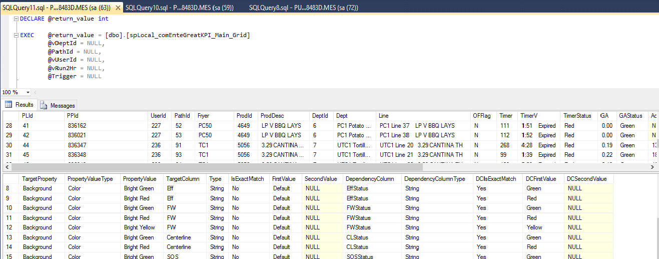

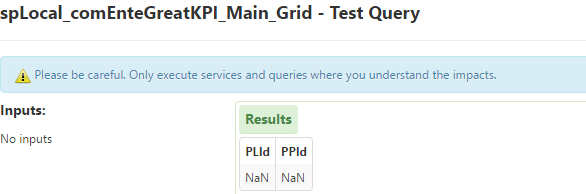

I have Stored Procedure that will return Two Result Sets . I am Trying to Execute This Stored Procedure from Thingworx Service But unable to get results.
While I am running stored Procedure in MSSQL Database i am able to get values in 2 result set but when i run Same Procedure in Thingworx Service nothing is coming.

In SQL Server When I execute stored procedure it is getting result in 2 result set

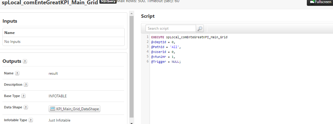

In My scenario the above values i have to display in Datagrid in Thingworx Composer.
Steps I have done.
1)I have Created a Datashape Which have all columns which we are getting from Stored proecure.
like PLID,PPId,UserId,PathId(resultset1 columns) ..................................................TargetProperty,PropertyValueType,PropertyValue....................................etc(ResultSet2 columns) in single datashape.
2) I have Created a Service to call my stored procedure.  by mapping my Datashape  "KPI_Main_Grid_DataShape" to service.
The Stored proecure Expecting some input parameters i am passing default values to execute stored proecure.
Note:- Here my issue is i am unable to get values from stored procedure when i call from thingworx service.
