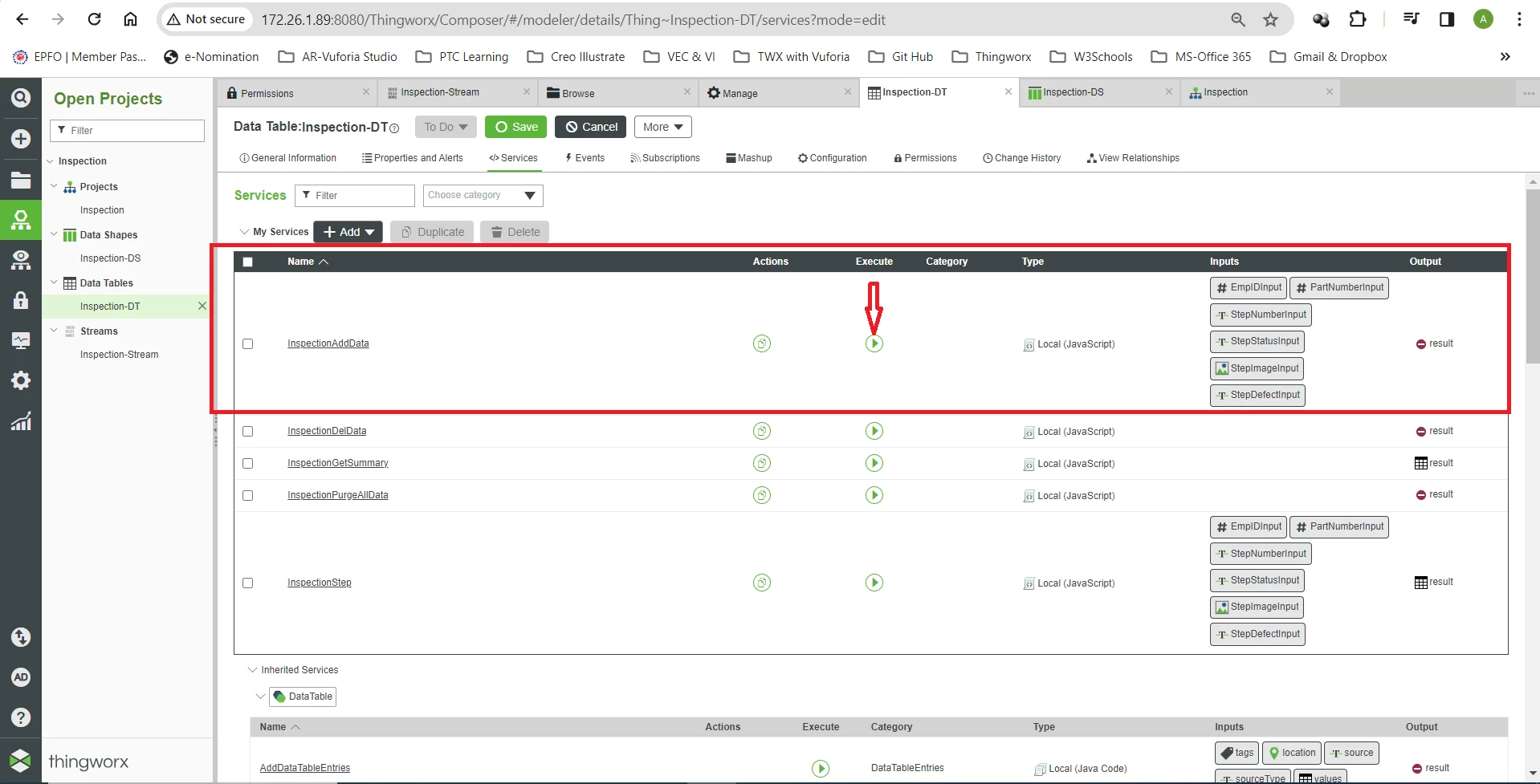

I am using stream to store values.
It's working but the problem is after every single record I need to manually press the execute button in ThingWorx service to store the data into Stream.
Eg. I capture record1 then need to manually press execute button of ThingWorx InspectionAddData service.
Capture record2 again manually press the execute button in ThingWorx InspectionAddData service.
Capture record3 again manually press the execute button in ThingWorx InspectionAddData service.
Now the problem is, how can I trigger execute button of ThingWorx InspectionAddData Service from Vuforia Studio?

add the line
me.InspectionAddData();
to your service InspectionStep

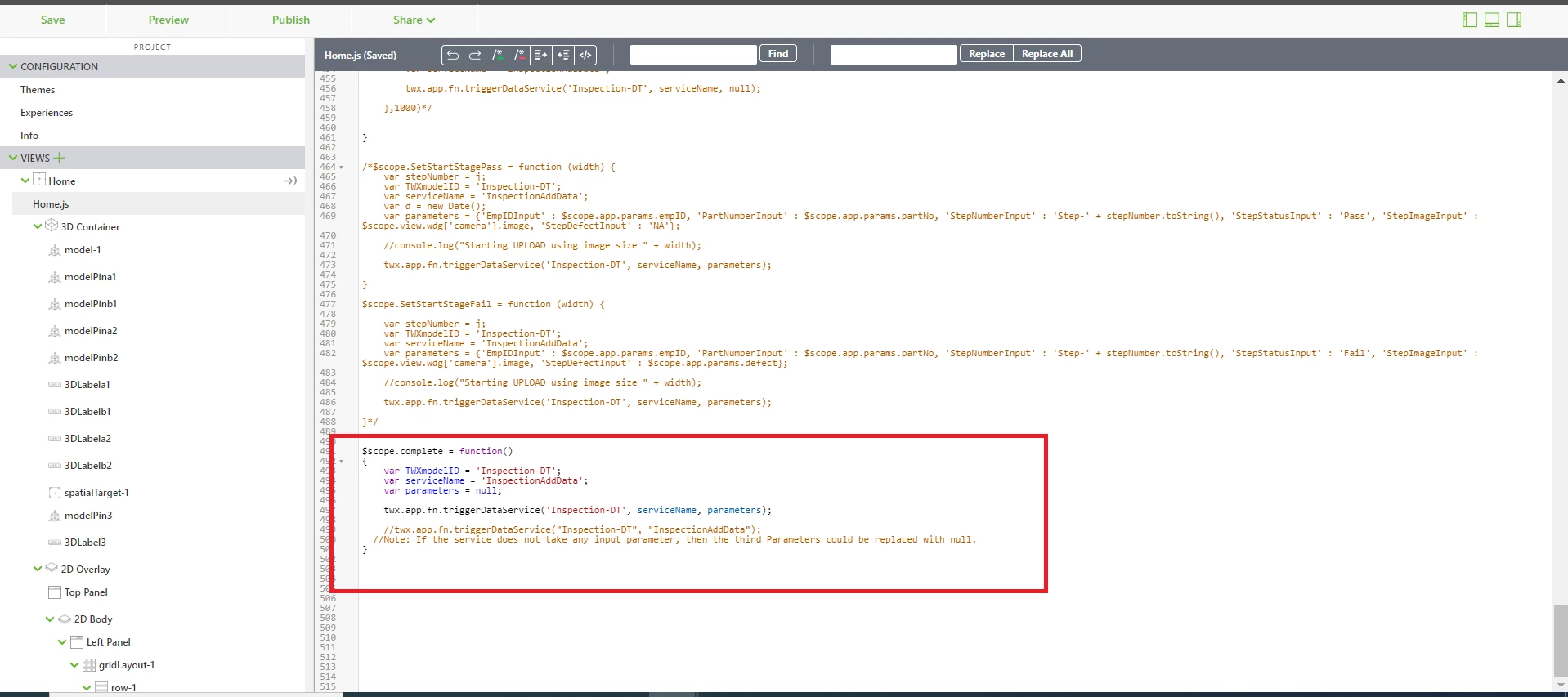

I have written a function to call the service in Vuforia Studio and I am calling it on the click event of a button widget but it is still not working. '
I have attached the reference image.
Also note that the service I want to call has  no inputs & outputs, its just a service to enter the data into ThingWorx Stream.

Apr 2, 2024 8:56 AM UTC
In you other post you wrote you enter the data using the service InspectionStep. https://community.ptc.com/t5/ThingWorx-Developers/Property-values-are-repeating-while-using-QueryPropertyHistory/m-p/940291/highlight/true#M66168
Why don't you call InspectionAddData  from inside of InspectionStep?
