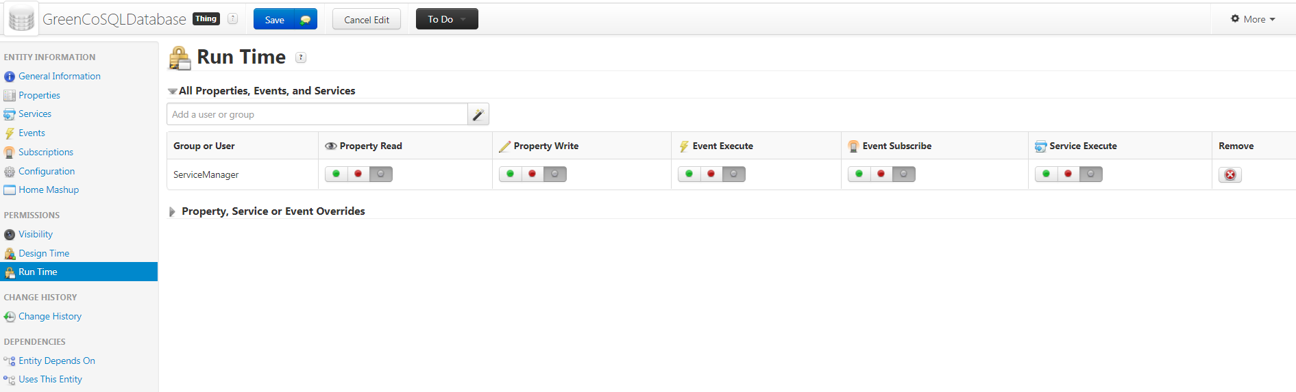

  • Select the Thing for which you are going to assign permissions for the user to the service.
  • Select Run Time Instance link in the Explorer as shown below:

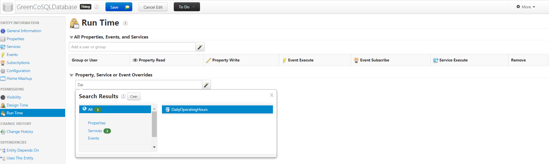

  • Type the Service or select a service in the Property,Service or Event Overrides filed as shown below:

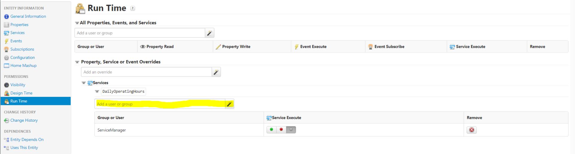

  • Select the user or type the user name in the Add a user or group field as shown below:
  • Select the green dot below the service Execute permission for the service.
  • Click the save button.
