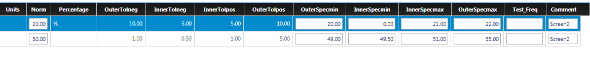

Good afternoon community,
I have a problem with the cells formatted as numbers in the Grid widget. They can have a null (empty cell) when it gets the data, but after you actually edit the cell in the grid (let's say that you write a 55 like in the OuterSpecmax column, second row), it's impossible to have an empty cell again. If I delete the value, and choose a different cell, the value from before (55 in this example) comes back. This is a big problem for me since if the cell is null, I shouldn't use it, but if it has a value, I should. Converting the column to string is not an option because of the dot/comma usual problem when parsing.
I have been checking the code of the Widget itself (the dhxgrid.runtime.js) but I can't find in which part of the code they actually check if the input is "nothing" to write back the value from before.

Hello, Josue.
Is the code dhxgrid.runtime.js you have out of the box, or is it modified? Which version of ThingWorx do you have?

Hi Craig.
It is the code from the Grid Widget that ThingWorx brings when installing it. And the version that I am using is the 7.2.4
