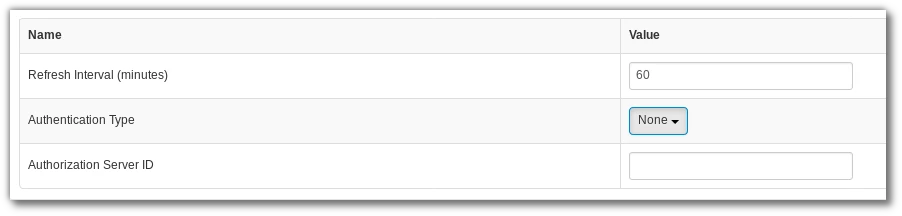

No Auth ( driven by SSL certificate... )

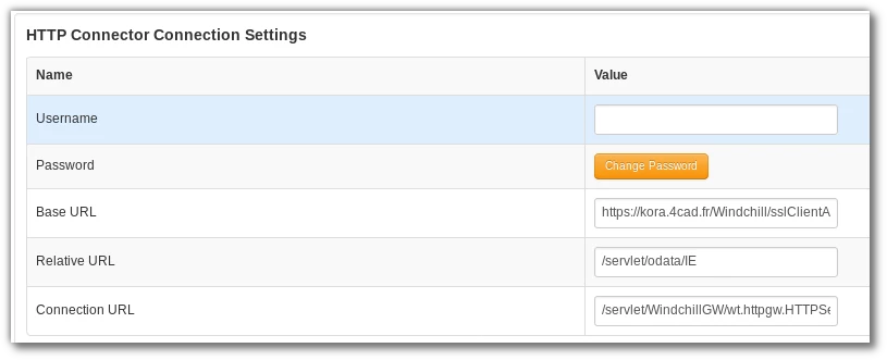

Connection definition
Base url is https://kora.4cad.fr/Windchill/sslClientAuth
Also added
But when I try to use the "validate connection" service, 403 error, and in PDMLink log

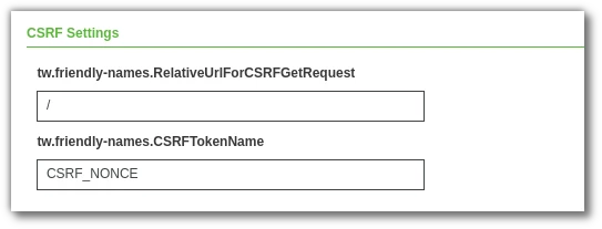

PDMLink's REST API is protected of CSRF attacks, so you have to use a  specific header in the request.
Only the POST requests, GET requests don't need it.
I thought that the connector's CSRF settings would do this, but it doesn't
I checked the network exchange with wireshark, no CSRF token.
So it fails...
Now I need to find how to set this token, maybe in the GetCustomHeaderParameters, but I need to make a call to PDMLink to retrieve the token !

var authType = row.getStringValue("AuthenticationType");
if("None".equals(authType)) {

Setting Relative URL to: /servlet/odata/IE restricts the connection to the IE endpoint. Using /servlet/odata will allow access to all endpoints.
