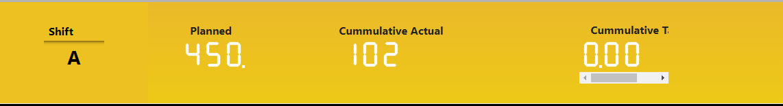

i want to dynamically change values in the above image , for SHIFT i ve used a label and the values are displayed using a VALUE DISPLAY WIDGET. now as the shift changes to A,B,C i want the values to change respectively . can you pls tell me how to do it.
Thanks.
    22-Sapphire I
    December 6, 2017
    You would create a Service with an Input Parameter of Shift to get the related values.
    So now as shift changes it will fire that service and bring back the appropriate values.
    Shift itself will have to be selected through some other method and be assigned to shift and the input parameter.
