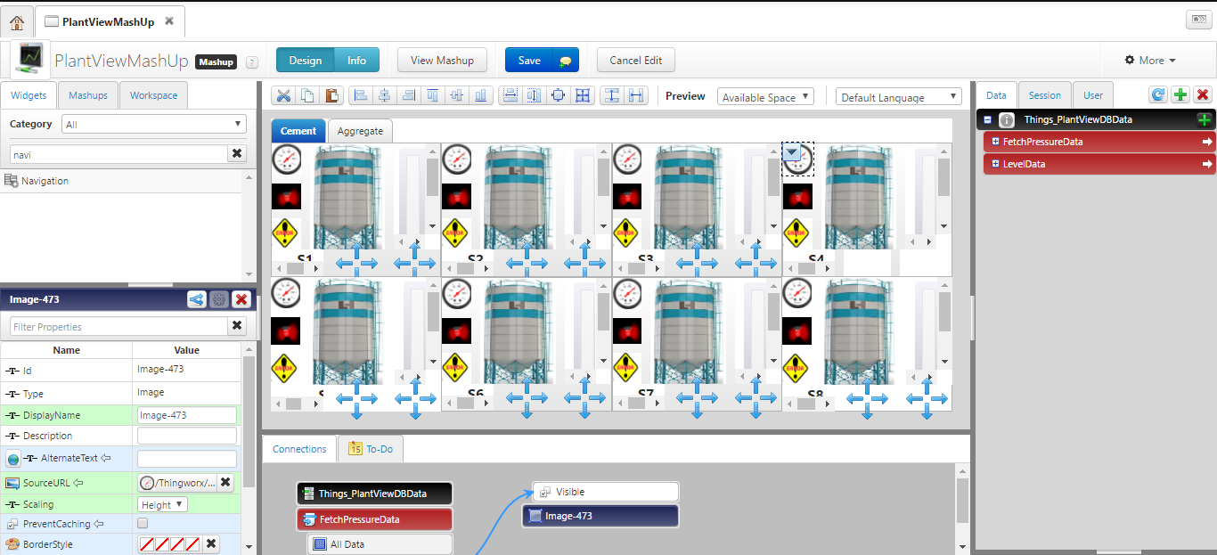

Can any one help to achieve this functionality.

    What widget are you using as an image output?

    Please find below screen shot I have to show/hide image-473 based on value I get from service 1 or 0.
    if 1 show, if 0 hide like that

    Please try this link, validator widget would be a perfect solution for you:   https://support.ptc.com/appserver/cs/view/solution.jsp?n=CS250781&lang=en_US
    • The Validator Widget is an invisible widget that is used to perform operations on data currently entered in the Mashup
    • The Validator Widget is a simple version of the Expression widget as its OutputBaseType is set to Boolean
      • For detailed description of Expression widget, please refer to CS233996
    • The Validator Widget has True and False Events and can be used to trigger other services, which is easier to use than the Data Changed event in Expression widget

    • Define the expression
      • Expressions support all JavaScript comparison operators.
      • For simple comparison expressions, the if() else() would not be needed
        • If the input is Boolean type, "input" can be put directly in the expression field
        • If the input is numeric type, "input ==1" can be put directly in the expression field
    • Evaluate the expression
      • The Expression widget is triggered by the Evaluate widget event.
      • There is a AutoEvaluate checkbox, and the evaluate the expression when input is changed
      • This event can be bound to a button widget's Clicked event, or as part of an input field widget's Changed event.
    • Returning result
      • The result of Validator widget is a Boolean type, it can be used to disable or control the visibility of other widgets
      • The True and False event can be used to trigger other services or events like Navigate, Execute or Refresh
    May 10, 2017
    Think of ValueDisplay widget which can show Images and has StateBased formatting
