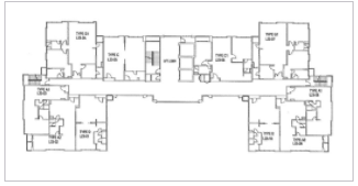

But I want to let image to suitable to different screen size:
If I choose to let image in the panel suit the 1024*768,

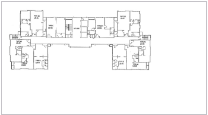

1280*1024 will like this:

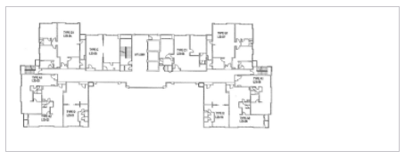

1366*768 will like this:
My concern is: if I place other image over this image in the panel, the image effect will be affected by the screen size.
