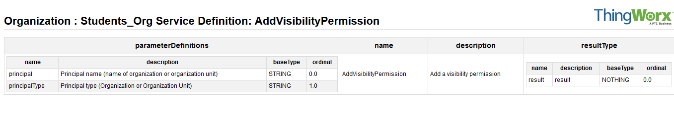

You can see what options exist for the parameters expected in a given service through the service definitions of that thing.
In your case this is the link where you would find the possible values for the AddVisibilityPermission service parameters
http://127.0.0.1:8787/Thingworx/Organizations/Your_Org_Name/ServiceDefinitions/AddVisibilityPermission

Thanks.  The "principalType" must be set to "OrganizationalUnit".
Using "Organization Unit", as the service definition states, will produce an exception.  The service definition information is wrong.
