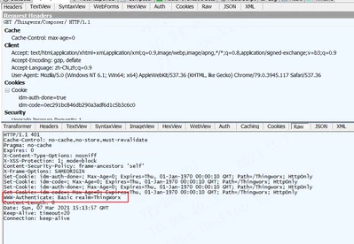

I created a customized authenticator and it throws AuthenticatorException exception if fail to authenticate.  The exception does block the login, but the browser displays a blank page.   I also tried to set the request status to 401, but no difference.
I expected the browser can redirect to a general login error page with the error message of the AuthenticatorException,   it this a out-of-box feature in Thingworx ?

There is an authentication method called issueAuthenticationChallenge that will allow you to set up a failure condition.  This will allow you to redirect, log an error, throw up another login, etc., but I'm not able to find a lot of information on it.  I am reaching out to our internal teams to get more information.  You might want to play around with this method in the meantime and pass along any questions.

I tried throw AuthenticatorException, but the server just response with http code 401 and the browser's login prompt get displayed instead of user friendly error page .

The following code is what I called in the method issueAuthenticationChallenge:
AuthenticatorException authenticatorException =
new AuthenticatorException(
new InvalidRequestException(exceptionMsg, StatusCode.STATUS_UNAUTHORIZED));
authenticatorException.setAuthenticationType(AuthenticationType.AUTH_THINGWORX_FORM);
throw authenticatorException;
 I notice that the web.xml has error-page for code 401 configured,  but I have no idea why it's not captured .
one of the possible reason would be the response has to set  " httpResponse.addHeader("WWW-Authenticate", "Basic realm=realm"); "
http://www.axlrosen.net/stuff/401.html(https://bz.apache.org/bugzilla/show_bug.cgi?id=13430)
but I found the response does has the setting ,  any more idea ?
