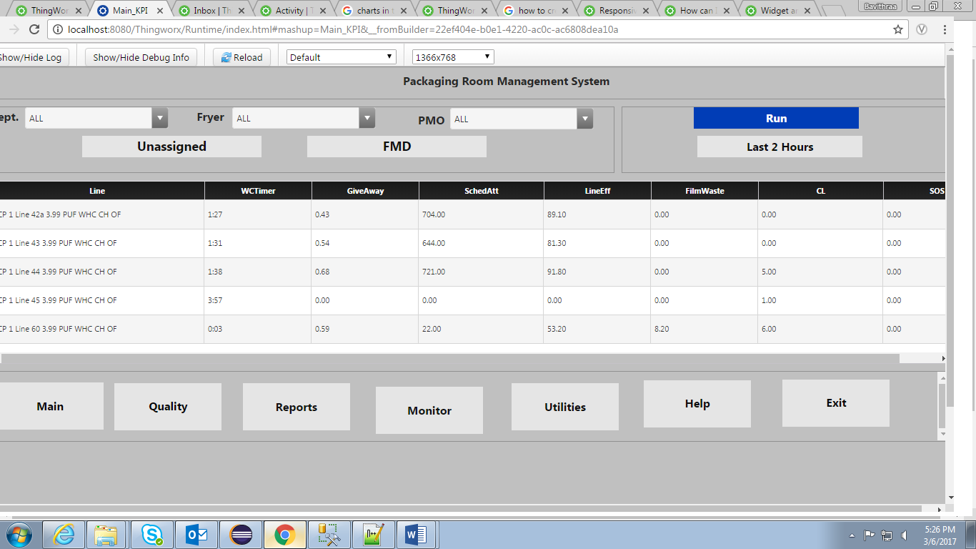

This is the mashup I have created. But I don't want that vertical scroll bar in the screen. how can I remove that scroll bar??

Hi Bavithraa, you probably need to align those buttons, as they don't appear to be in the screenshot and ensure that there's no extra pixels exceeding the frame in your Mashup, else it will show the scroll bar

I dont want that scroll bar in the mashup screen. I want my screen as fixed one
March 6, 2017
Yes, that's why you have to align and keep the objects within the frame for e.g. the Exit button on far right is way over the first button on the left. You can align them easily using
Like i said above the data in your frame should be slightly shorter to remove the scroll
