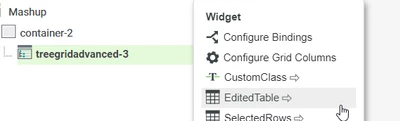

I have done the following binding, but still the edited data is not saving in the data base, the binding I have given in the below picture.
could you provide some solution?
Thanks in advance

You need to pass EditedTable to your Table_Update service. The table will contain the modified data which you need to do with what you need:
Most likely you also just want to call the Table_Update service on EditCompleted event (not on all events you have configured in the screenshot).
Also see:
- AdvancedGridsProperties.html "EditCompleted" and "EditedTable"
Hope that helps!

HI @nmutter ,
Thanks for the reply.
I was trying to bind as you said and after binding the grid is not editable.
I have attached the binding picture here, kindly go through it and provide me a solution.
Thanks in advance

I dont see that "EditedTable" is bound and passed to the Table_Update service of yours. Maybe this post will help https://community.ptc.com/t5/ThingWorx-Developers/Editing-an-grid/m-p/514615/highlight/true#M11105 .
