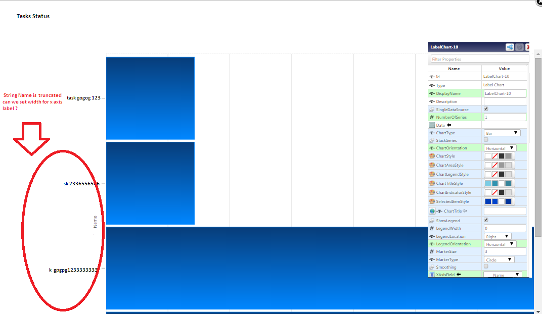

I am using label chart with Horizontal chart orientation. X-axis field is string (length more than 100) field names are truncated as you can see due to this . How to adjust the label width ? please refer screenshot for reference.

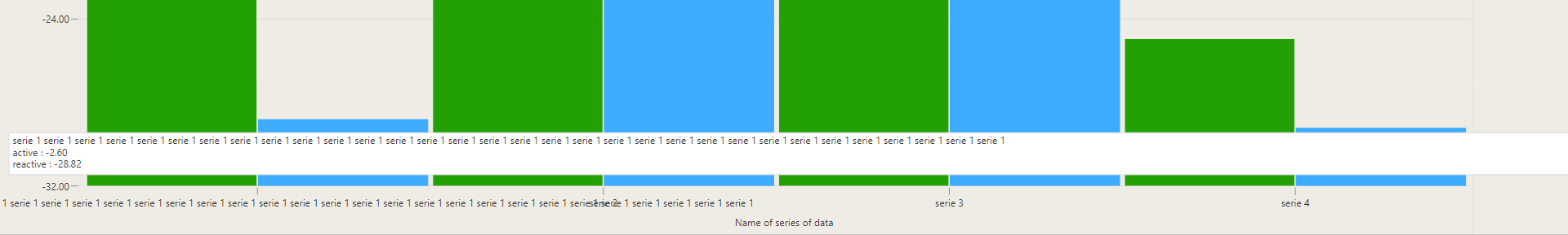

    I have the labels overwritten when the chart orientation is vertical. With horizontal orientation, the labels are truncated on the left too.

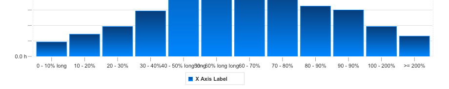

    I finally found a solution. The Custom Chart Widget extensions have issues, so:
    1. Go to the Composer and click on your Label Chart
    2. In the properties panel, Reset all X axis format properties
      1. XAxisStyle
      2. XAxisFormat
      3. XAxisLabelType
      4. XAxisLabelRotation
    3. Save then reload your mashup
    4. Labels are displayed without overrides. In some cases there is no space between labels but it's readable.
      Some labels are suppressed automatically to be able to have a correct display.
