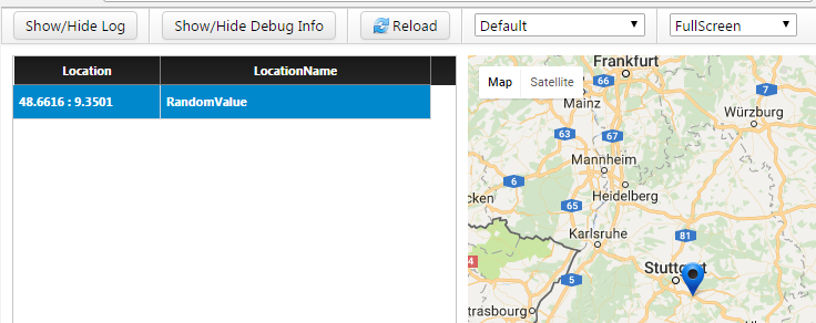

i want if select a Row about AlertQueryHistory
make mark on google map.
but Alert location Value was 000000:000000
how to set them?
if it was QueryPropertieHistory i can do that using addLocationValueStream or Me.Thing = item.GPS (item has real time data)
but i don't know how to set Alert location Value..
help me please~ and have a nice weekend ~~ thank you~

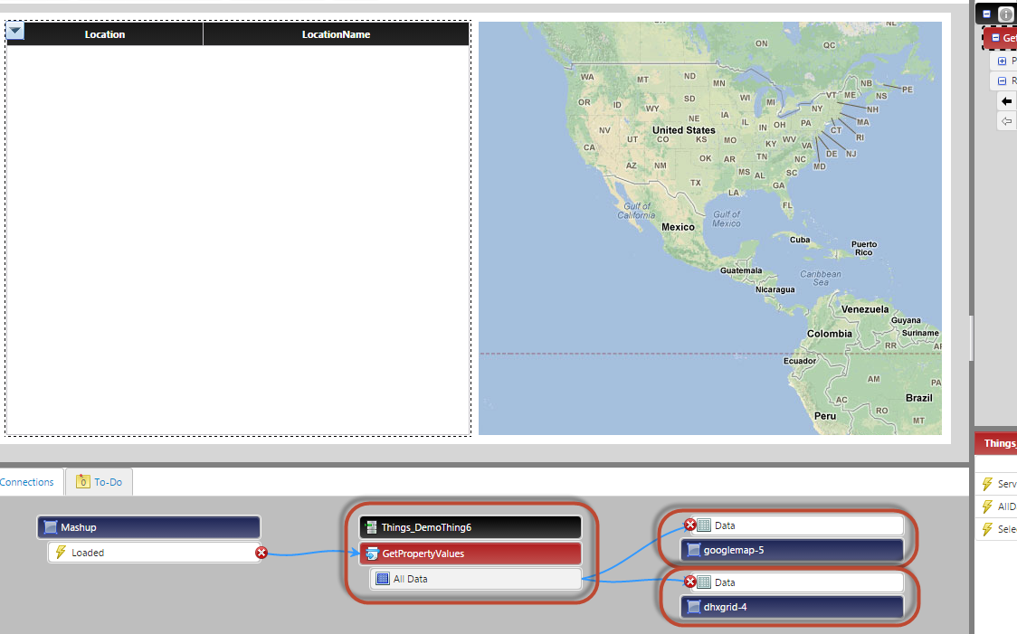

Hi Seonho, how is your Alert setup on the Property? Is it on the property storing Location? As to highlighting the location on the map which corresponds to a Location value you are displaying on the Mashup, you can simply use the same service for both widgets for e.g.
1. Create mashup with horizontal layout with 2 columns
2. In one column use Grid and in another Google Map widget
3. Call the service which is returning Location for you
4. Drag and drop all the data returned by that same service in both Grid and Google Map widget, like so
5. View the Mashup and you shall have the Grid widget and Google map with same data to reference so clicking on the row in Grid will highlight the marker on the map, like so
