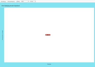

Line charts cannot be displayed in the mashup with respect to date and time even if it is designed according to PTC guide as a reference. Below is the example to display the temperature with respect to present date and time and how it is binded with and the result after saving the mashup is displayed as an error in the next image
•The Date/Time Property is not considering the Present date time and year , even if we set the Property to the today’s date and save it and once if we refresh the page by default it will take it as 1970 /01/01 . IT is shown in the below image
please help to get the proper line chart with respect to time and date.

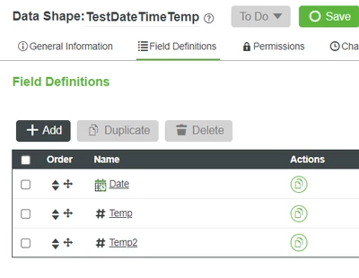

Start with creating a data shape containing a date and your temperatures.
Something like this:

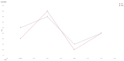

You can then use this infotable as your output and connect it to your line chart like this:
Where "UnionTest" would be the name of your service and:
The XAxisField is set to your date.
This should give you something like this:
Obviously it would look a bit different for you. But in general it should work like this.

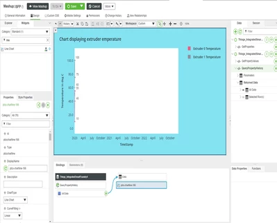

I just made a quick test and you might want to reduce the max date range for your x-axis:
This will better show your temperatures.
Also, make sure that your X-Axis type is set properly:
When it comes to the error, this is most likely due to an issue with the service. If you open your developer console (f12 in chrome) and look under the "network" tab after a refresh of your mashup you should see your service "QueryPropertyHistory" as red.
If you press that and look under the "Response" tab you should be able to see some error message.
Also, I'm not sure if the "QueryPropertyHistory" is able to be used as you are trying to use it.
If you could screen cap the service like this:
To see if the "All Data" infotable actually contains your values or not.
It looks like perhaps it doesn't contain all the data you need.

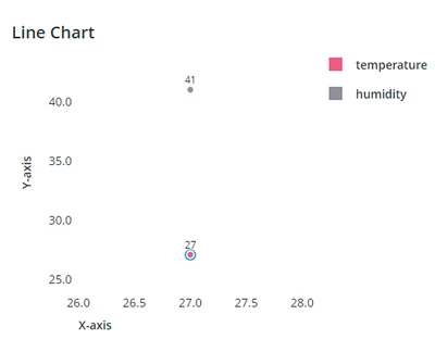

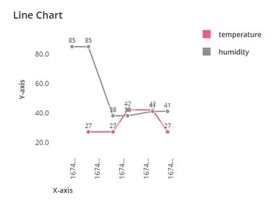

Here are some snaps after using "getpropertyvalues ", here i have sensor logged data of dht i.e., temperature and humidity
but the graph looks like it is showing me only one data at a time that too if use timestamp then it gives me an error
and if i use the info table then i get the line graph but only for the data which i give it will plot for that as shown below
and i have checked in chrome (f12) regarding any error message for "querypropertyhistory" service and i am not finding any problem in it , the issue is with date and time because it takes the old datetime as 01/01/1970 the graph is not appropriate to use. IS there any solution please let me know so that i can work on it further.
