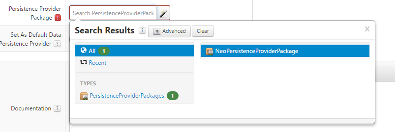

Hey Carles Coll
I don't know How could I access PostgresSQL and Cassandra as I have only 1 persistence provider that is NeoPersistenceProvider.
may I use external PostgresSQL as twx persistence provider?
Meenakshi
November 2, 2016
Well, moving to PostgresSQL won't be that easy. You should have to export everything and import it again to a ThingWorx instance with PostgresSQL support.
Moving to cassandra it's about moving only streams, and here I don't have experience either I don't know if additional licences are needed, better you contact support for this.
Carles.
