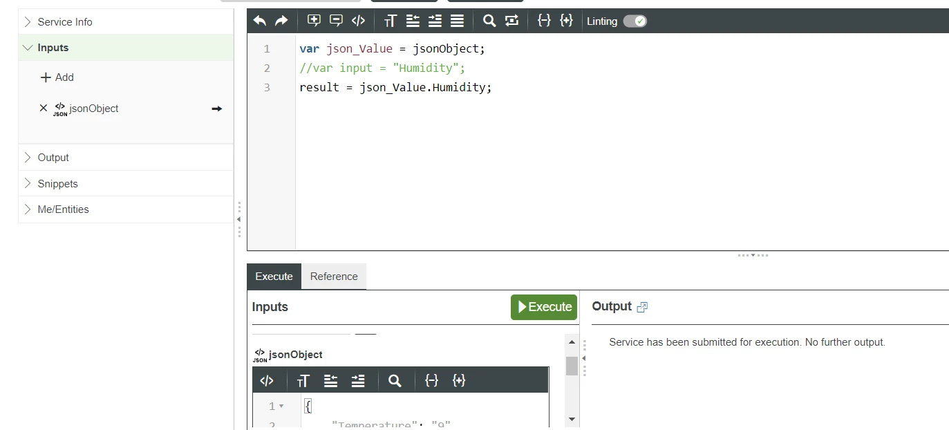

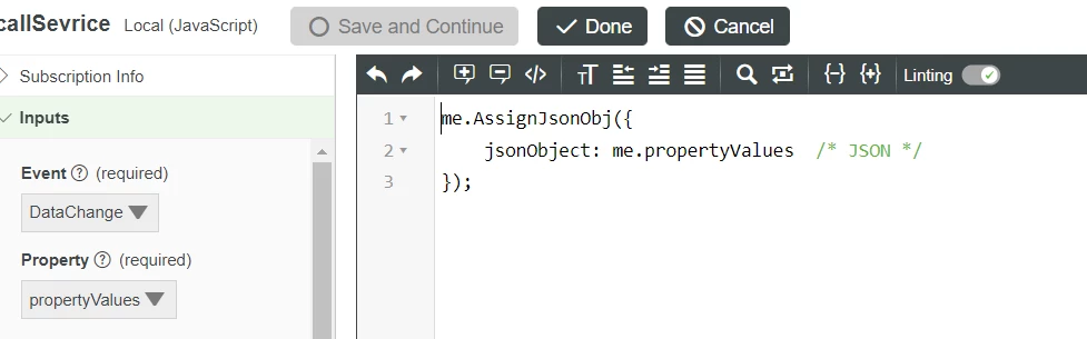

I want to write a service to output the values that are inside of my json object. I also have a subscription that calls this service.
I have attached screenshots of my code below. Unfortunately I do not get the desired output. Any suggestions on how to fix this?

Seems like you are enabling "Async" of this service. You may try with normal service by unchecking that option in Service Info tab.

Janicen16-PearlAuthor
June 7, 2022
This worked.
Thank you @CharlesJi
