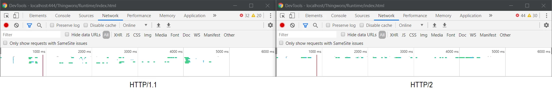

Hi All
Have you experimented with HTTP/2? I suspect that the TWX Composer would load faster in the browser, because there are so many JavaScript modules, particularly if the server is not local. The Runtime might load faster too. Have you timed this by any chance? It is an easy test if you have access to the server, just put HAproxy in front of Tomcat (and Apache?). Or reconfigure Tomcat (and Apache?). Then open Chrome Inspect Network tab and reload.
Thanks -- Rick
Best answer by Constantine
Hello Rick,
TL/DR; It doesn't make any noticeable difference in terms of speed or subjective user experience.
I've just tried it -- our application "dashboard" mashup loads on average within 5.25s with HTTP/1.1 and 5.27 with HTTP/2 (average over 10 executions). The same with the Composer, which in my case loads within 3.10 seconds, with <5% random difference between two protocols.
To test it I have two nginx running side-by-side on different ports. The only difference is "http2" bit in the config:

Note that you have to use SSL/TLS, otherwise it won't work. I use the latest version of Chrome and measure performance using Chrome DevTools. ThingWorx 8.5.3-b123 on localhost.
I'm attaching the screenshot which demonstrates the difference between the two, where it's easy to see how HTTP/2 multiplexes requests. Thanks to HTTP headers compression HTTP/2 saves 3KB on 472KB download for Composer, so less than 1% saving in terms of traffic.

FWIW disabling TLS doesn't make it any faster either.
rleir17-PeridotAuthor
March 4, 2020
Your server is on localhost. Having a remote server makes a difference, according to the Manning book.
thanks -- Rick
