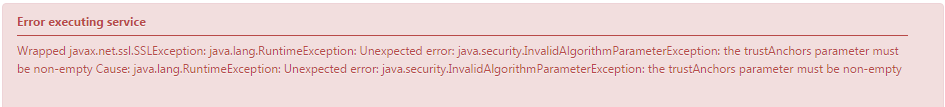

I have error about reverse geocoding
  • April 20, 2017
  • 8 replies
  • 2998 views
it was great
because it was working still yesterday
but Today!!
error!!!!!
please .. how to fix it?
thanks

Hi seonho Cha​,
Does it work when you use http instead of https?

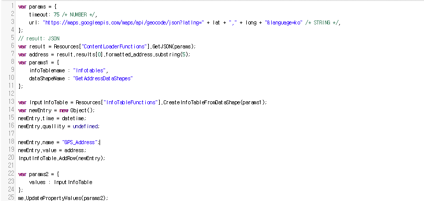

Also, please share the code instead of a Screenshot of code.
April 20, 2017
Also, the error seems to be related to SSL try adding following in the params:
ignoreSSLErrors: true /* BOOLEAN */,

this is my code
and i add that but still error...
var params = {
    timeout: 75 /* NUMBER */,
    url: "https://maps.googleapis.com/maps/api/geocode/json?latlng=" + lat + "," + long + "&language=ko" /* STRING */,
// result: JSON
var result = Resources["ContentLoaderFunctions"].GetJSON(params);
var address = result.results[0].formatted_address.substring(5);
var params={
    infoTableName:"UpdatePropertiesInfoTableTMP",
    dataShapeName:"NamedVTQ"
var updateValues = Resources["InfoTableFunctions"].CreateInfoTableFromDataShape(params);
updateValues.AddRow({'time':datetime,'name':'GPS_Address','quallity':undefined,'value':address});
me.UpdatePropertyValues({values:updateValues});

i  did not turn off Computer about 7days.
and it's code works very well before today...
