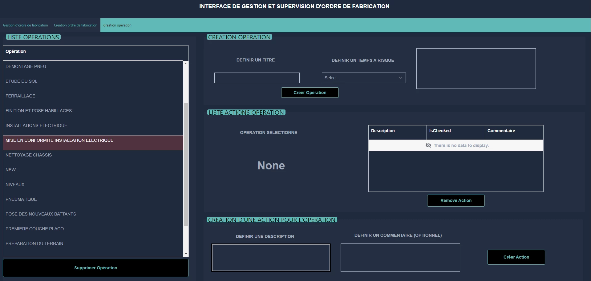

I want to change the scrollbar style
Hey everyone !
I am design a good loking ui interface, anyone know if it's possible to change the color/style of the scrollbar in the mashup ?
here is a screen of my front-end application :

I did tried to add the following code in the custom CSS:
body * ::-webkit-scrollbar {
width:5px;
height:10px;
/* Track */
body * ::-webkit-scrollbar-track {
background:#3c6380;
/* Handle */
body * ::-webkit-scrollbar-thumb {
background: #12243a;
 but I got no change from it. I did noticed however when running the application on firefox, all the scrollbar were actually dark (I don't know why) so as it is not meant to be a deployed app but more like a demo project, I'll use firefox for it instead of Chrome.
