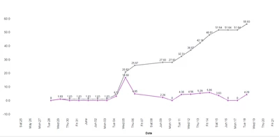

i want to show the combination of Bar and line chart on same graph
  • June 18, 2024
  • 4 replies
  • 1239 views
i have two rows as output , now i using line chart for the same to show the graph
now here the requirement is,  want to show violet/scion color line graph as bar chart and gray color values as line chart how to achieve this combination is same widgets of chart

Hi @Suraj_Patil  For this requirement you can use a combo chart.
June 18, 2024
Take a look:
June 18, 2024
June 18, 2024
combo chart is available in 9.5 and above version only right?
June 18, 2024
Hi @Suraj_Patil  From 9.4 and above.
